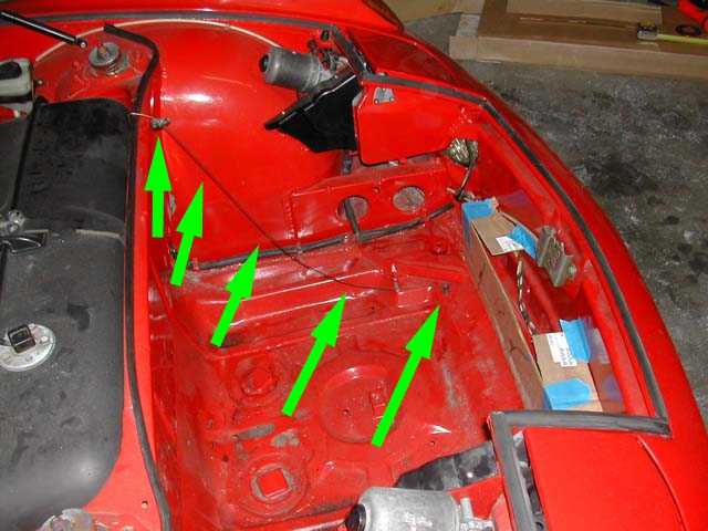

we also made a cardboard mockup of the oil-cooler and used a small metal rod to mock up the curvature of the air-channel (see green arrows) ...
it'll be a nice and smooth curvature and should give me a good airflow ...
