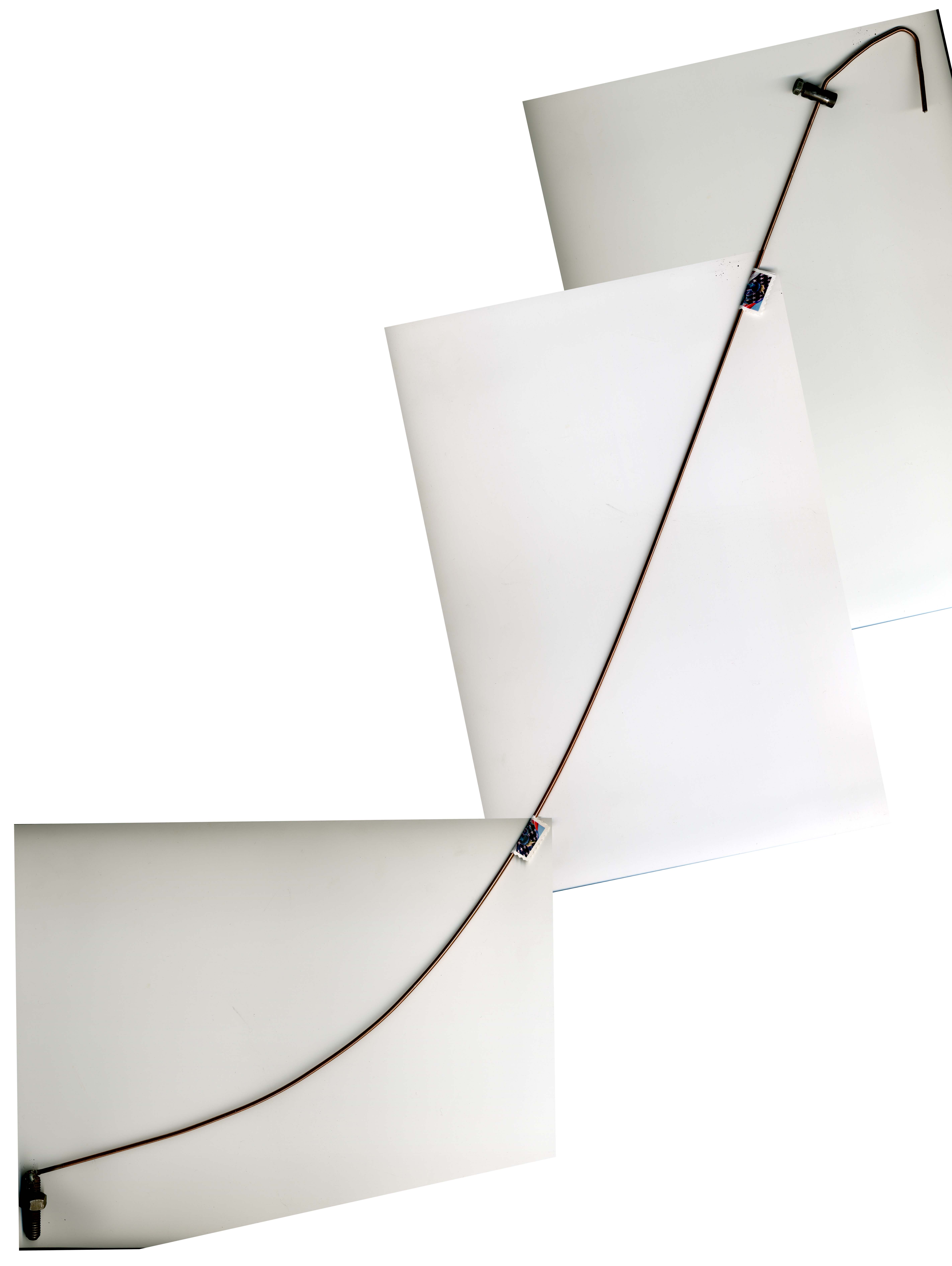

here's a link to a HUGE jpg (1:1 scale) of the shroud/channel outline ...
i'm going to clean this up, run it through adobe streamline and make it a vector graphic EPS.
then, i'll have the shroud lasercut out of aluminum sheet metal ...
WARNING, HUGE IMAGE (5689 x 7564 pixel, 300 dpi) ...
http://www.914world.com/pix/mycar/Oil%20Coo...ine%20small.jpg
(IMG:http://www.914world.com/bbs2/html/emoticons/type.gif) Andy
