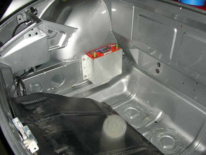

1/21/06 Battery mount

Marv's3.6six   1/21/06 Battery mount   Jan 29 2006, 09:39 AM
Marv's3.6six   1/21/06 Changed my mind and decided to mount the r...   Jan 29 2006, 09:41 AM
