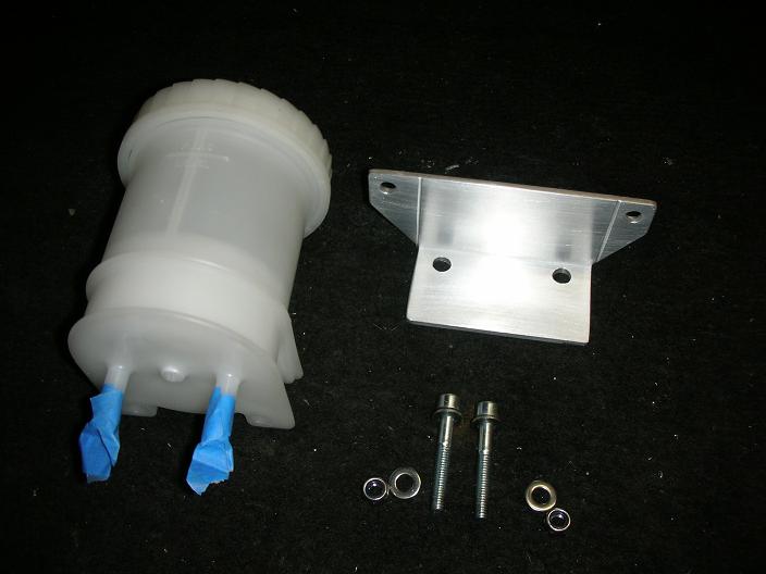

1/21/06 Changed my mind and decided to mount the rese in the stock location. Fabricated a brake fluid resevoir mount to go in factory location
