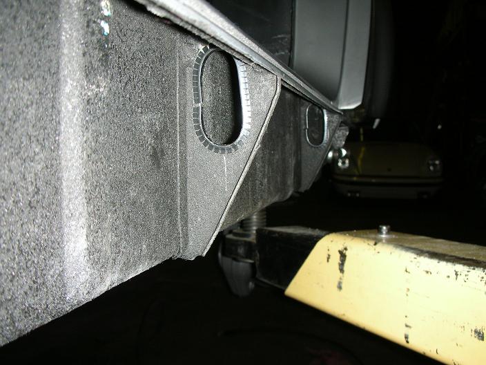

1/21/06 Grinded out existing holes for oil lines to run under rocker panels.
