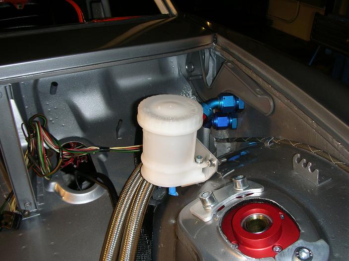

1/25/06 Brake fluid rese mounted, hood hinges mounted.

Marv's3.6six   1/25/06 Brake fluid rese mounted, hood hinges moun...   Jan 29 2006, 11:04 AM
