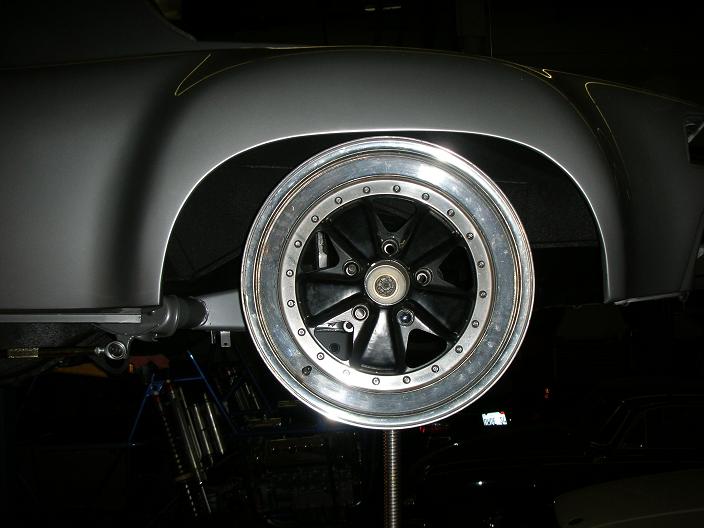

1/25/06 rear wheel test fit. Gonna have them refinnished, have to decide, whether to make them black, or Iron glimmer (the darker gray you see on the suspension arm) or red? Hmmm (IMG:http://www.914world.com/bbs2/html/emoticons/huh.gif)

jim912928   the rims...have them match the exterior paint sche...   Jan 29 2006, 11:10 AM
