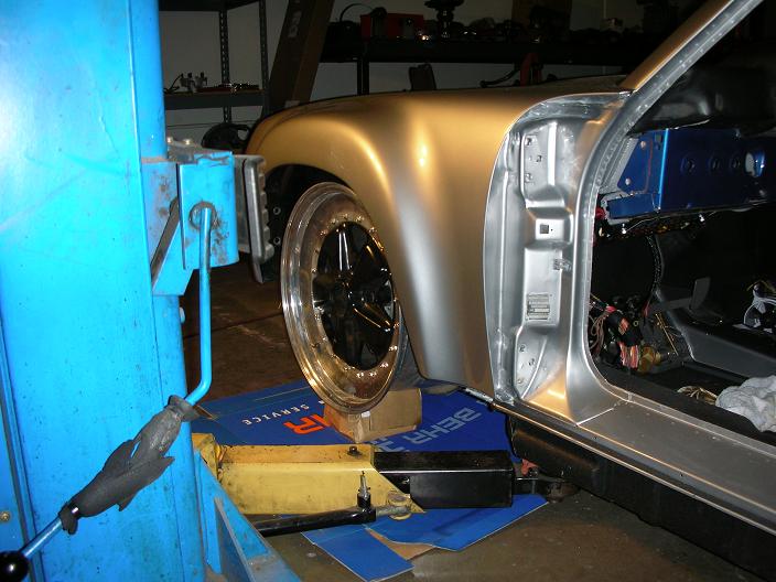

1/28/06 Front wheel test fit. The wheel looks pretty mean in black! hmmm, the car looks crazy in person, I'm getting excited. (IMG:http://www.914world.com/bbs2/html/emoticons/drooley.gif)
