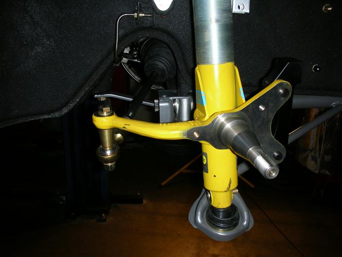

Marv's3.6six   1/07/06 Passenger side mono ball.   Jan 8 2006, 08:59 AM
Marv's3.6six   1/7/06 Bilstein RSR drop spindle strut mounted to ...   Jan 8 2006, 09:03 AM
