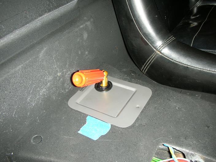

1/28/06 Brake bias valve installed.

Marv's3.6six   1/28/06 Brake bias valve installed.   Jan 29 2006, 11:34 AM

brp914   seems like an odd place for the thermostat. the p...   Jan 29 2006, 02:03 PM
J P Stein     Jan 29 2006, 05:25 PM
trekkor   Here's mine. I've seen one mounted behind ...   Jan 29 2006, 06:19 PM
