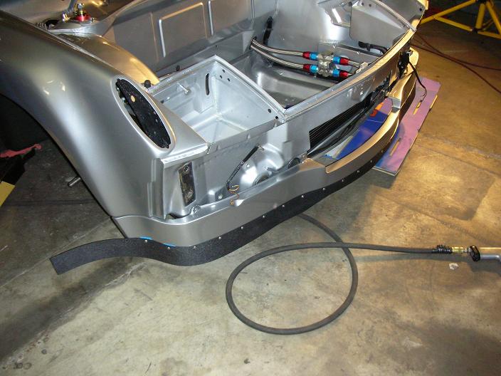

Marv's3.6six   1/29/06 Fabricating lower valence, ABS spoiler.   Jan 29 2006, 08:16 PM
Marv's3.6six   1/29/06 Lower valence with spoiler, front view.   Jan 29 2006, 08:18 PM
Marv's3.6six   1/29/06 Side view. http://www.914wo...   Jan 29 2006, 08:20 PM

Jeroen   nice! Is that a regular GT front valence? Or s...   Jan 29 2006, 11:08 PM
Marv's3.6six
