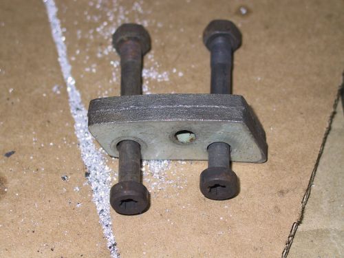

Got my spacers and bolts from Parts Heaven, and I'm pretty happy.
Here's what I got, four of these spacers, and eight bolts:

michel richard   Got my spacers and bolts from Parts Heaven, and I...   Jan 31 2006, 07:44 PM
michel richard   And the calipers, assembled. I still need to get ...   Jan 31 2006, 07:46 PM
