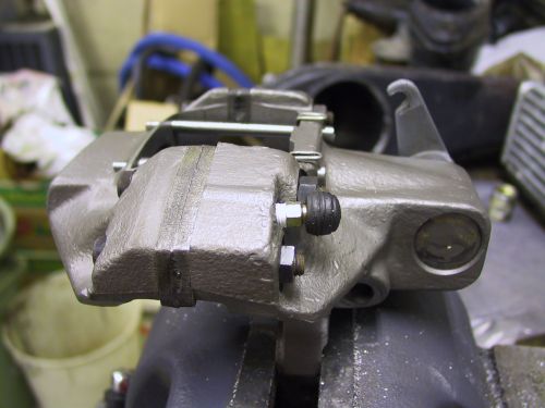

In the process of restoring my 914/6, I want to have vented rear rotors, mostly because I'm going to have a big engine, but also because I think it's kinda cool.
The stash of parts I bought from Jon Lowe contained some rebuilt original 914/6 rear calipers.
It also contained some good condition 911 front calipers "A" calipers I think: 3 inch bolt spacing, steel, and with a spacer. They had 48 mm pistons.
To build rear calipers that have a spacer, there is one recipe that uses the spacers from the rear of 911 mid-year calipers, as well as other hardware. Those spacers are 10 mm. I don,t have such calipers and initial attempts at getting some were unfruitlful.
So, I took the spacers from the front calipers that I have, but they're 7.5 mm thick.

And the calipers, assembled.
I still need to get the seals and new spreader springs from Eric Shea, but this is beginning to look like proper calipers. Note that the bolts are the appropriate length,
