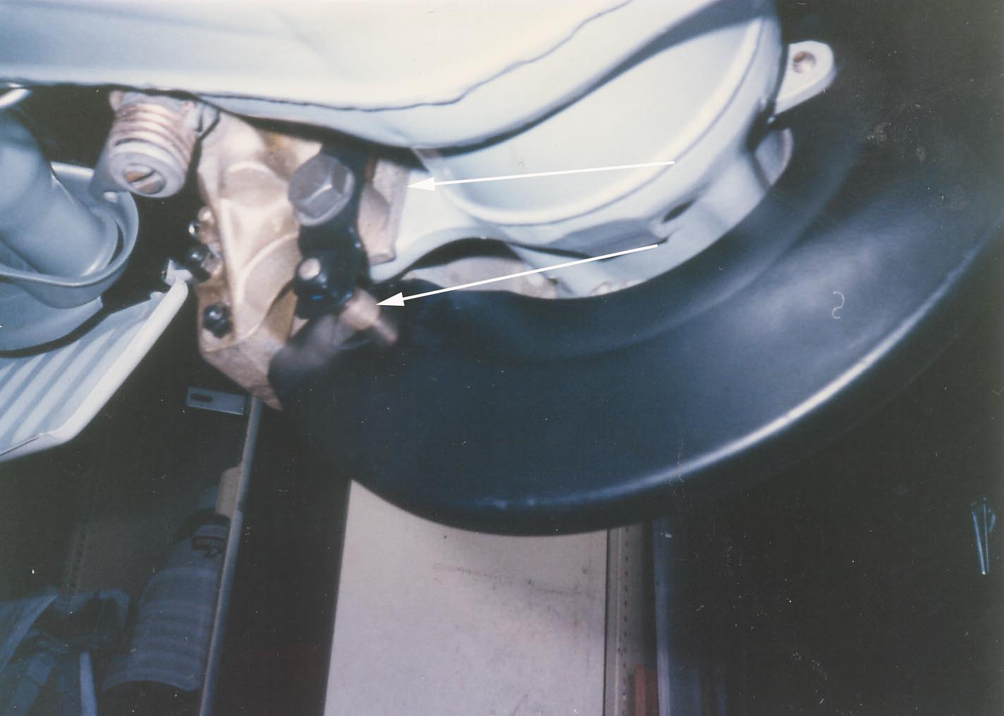

Here is how I utilized 914-6 calipers with 911 caliper spacers and vented rear rotors. In addition to splitting the calipers and 911 caliper spacers, I used a spacer between the caliper mounting bolts. I also wanted to use the stock dust shields so a spacer was fabbed between the dust shield and mounting bracket. DH
