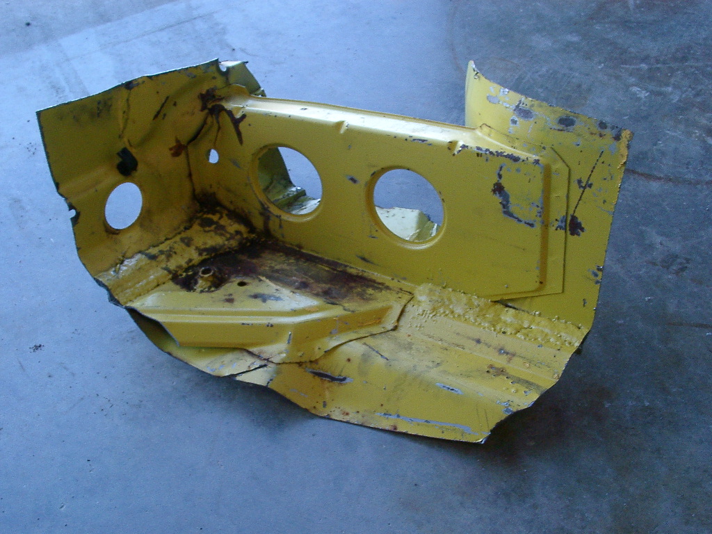

more "babysteps" ...
got off to a slow start, didn't get to marks until noon-ish. (IMG:http://www.914world.com/bbs2/html/emoticons/dry.gif)
so i decided to just cut out the new front support brackets. mine are shot (dumb PO (IMG:http://www.914world.com/bbs2/html/emoticons/headbang.gif) ) and i got two replacements from John at EASY.
of course he didn't drill out the spotwelds, he just cut the frontend around the pieces i needed,
so i had to drill out all the spotwelds to separate the bracket from the junk ...
here's a before picture (yellow! (IMG:http://www.914world.com/bbs2/html/emoticons/smile.gif) ):
