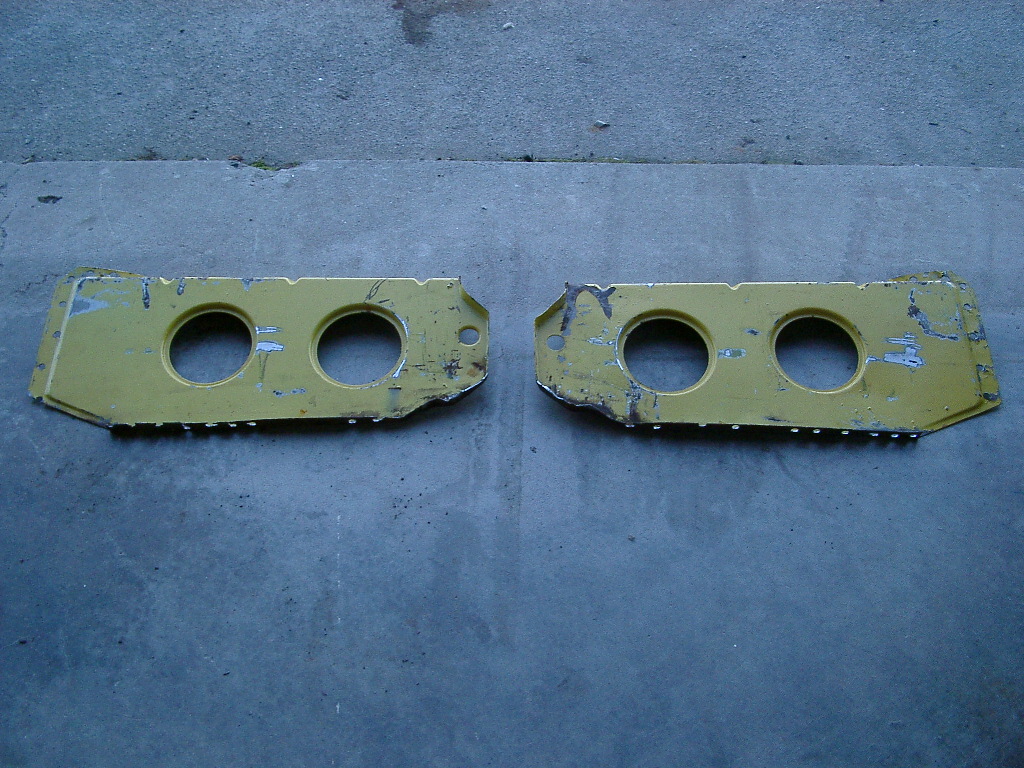

post Feb 4 2006, 11:04 PM
Resident German
Posts: 42,566
Joined: 21-January 03
From: Oakland, Kalifornia
Member No.: 179
took like 2 hours to get the two sides separated ...
well, with some BS and coffee breaks included ... (IMG:http://www.914world.com/bbs2/html/emoticons/chatsmiley.gif) (IMG:http://www.914world.com/bbs2/html/emoticons/beer3.gif)
