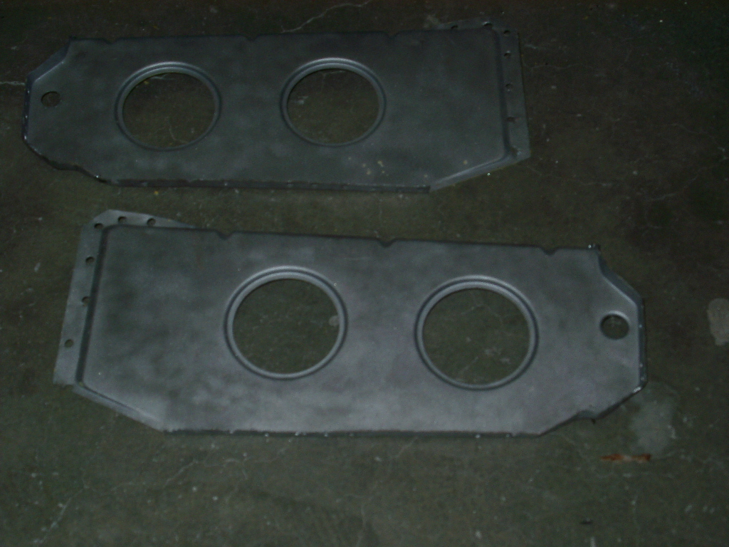

mark convinced me those would be much nicer all cleaned up, so we started up the bead-blaster box ...
turned out really nice, except, it takes FOREVER ... (IMG:http://www.914world.com/bbs2/html/emoticons/rolleyes.gif)

SirAndy   more "babysteps" ... got off to a slow start, did...   Feb 4 2006, 11:03 PM
SirAndy   took like 2 hours to get the two sides separated ....   Feb 4 2006, 11:04 PM
SirAndy   and then some primer, so they don't turn into ...   Feb 4 2006, 11:08 PM
