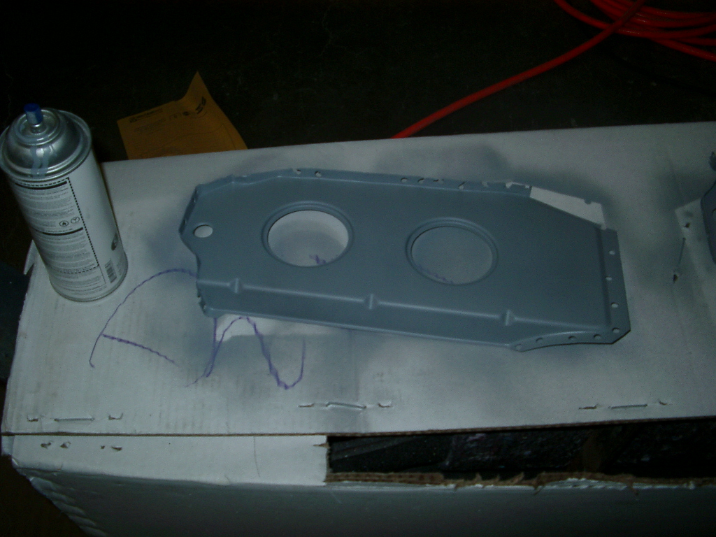

and then some primer, so they don't turn into a heap of rust by next weekend.
by the time the blasting was done, it was 6pm. time to call it a day.
i didn't get any of the other parts that i had planned on working with today, so this is going to be a short weekend.
hopefully more progress next week. including welding those babies in place ... (IMG:http://www.914world.com/bbs2/html/emoticons/welder.gif)
