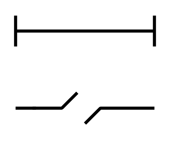

QUOTE (Aaron Cox @ Feb 4 2006, 09:13 PM)
cut 3x, fold 2x.....
quick and dirty photoshop mockup ...
3 cuts, one long horizontal, two short ones on the side (about 2" total) ...
then, bend front part upwards and bend rear part downwards ...
that way, each cut (louver) has a lip that will create suckage (neg. pressure) ...
this should help with the airflow ...
