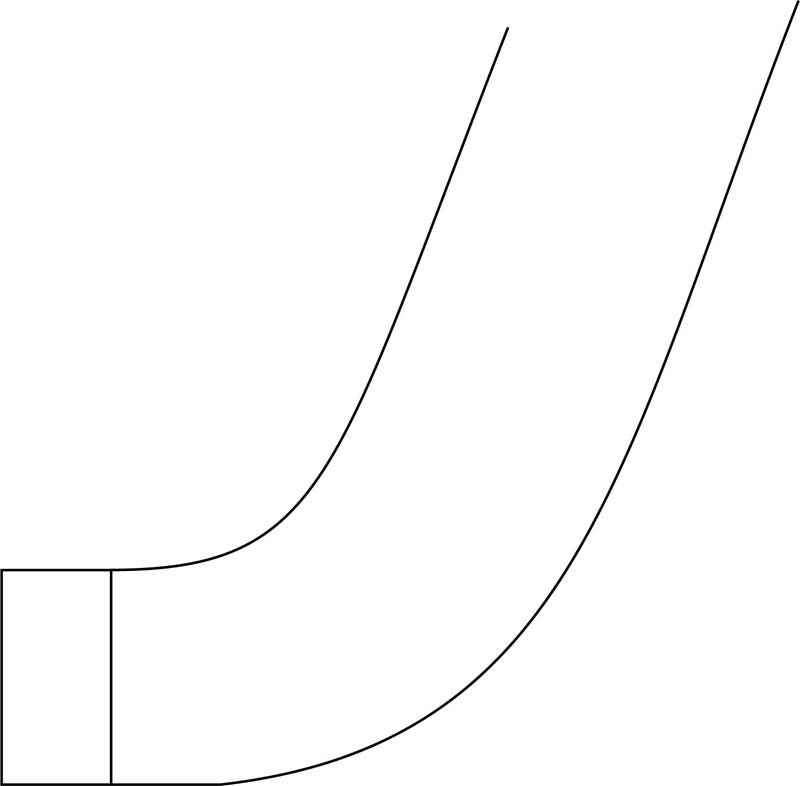

ok, here's a small JPG of the oil-cooler shroud lineart ...
the original is a Adobe Illustrator EPS in 1:1 size that Mark will use on his plotter to cut a template.
this should be fun ...
(IMG:http://www.914world.com/bbs2/html/emoticons/type.gif) Andy

jonwatts   I like the louver idea, but your air funnel looks ...   Feb 6 2006, 09:44 AM
Aaron Cox   have you thought about making the top / exit wider...   Feb 7 2006, 06:07 PM
ppickerell   Andy, I may be able to cut your shroud for you if ...   Feb 7 2006, 06:16 PM
McMark   ...   Feb 7 2006, 07:41 PM
SirAndy     Feb 7 2006, 09:05 PM
retrotech   I absolutely agree about dumping air under car, wh...   Feb 9 2006, 04:23 PM
