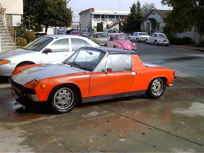

biggy72   This is the pic I put up on the garage door for my...   Feb 7 2006, 10:53 PM
