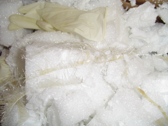

Did the layup, let it cure, and then shredded the styrofoam plug inside. It looks much less impressive in chunks.........Uh, turn your head and cough..... (IMG:http://www.914world.com/bbs2/html/emoticons/bootyshake.gif)
