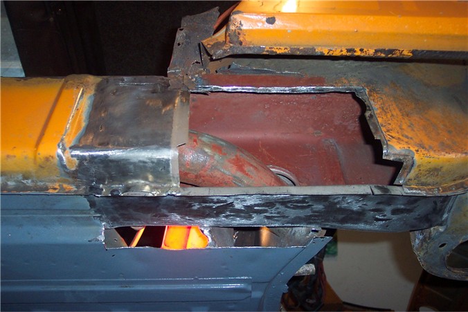

This piece is the end of the outer rocker, shaped like the original and with a flange to overlap with the lower wheelhouse piece. I almost forgot to put the heater tube back in; duh
Ed

elocke   This piece is the end of the outer rocker, shaped ...   Feb 19 2006, 01:16 PM
