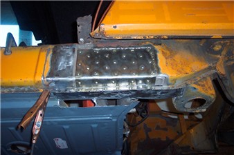

elocke   Here's that 1st layer installed.   Feb 19 2006, 01:10 PM
elocke   Then the bottom layer with flange to meet the oute...   Feb 19 2006, 01:12 PM
elocke   This piece is the end of the outer rocker, shaped ...   Feb 19 2006, 01:16 PM
elocke   This piece overlaps the outer rocker, as will the ...   Feb 19 2006, 01:22 PM
elocke   Outer layer installation.   Feb 19 2006, 01:23 PM
elocke   I didn't make the parts with the dents for the...   Feb 19 2006, 01:27 PM

elocke   Thanks...this was the pinnacle of the rust repair ...   Feb 20 2006, 09:25 AM

elocke   I basically copied the factory layout. When I cut...   Feb 21 2006, 09:04 AM
