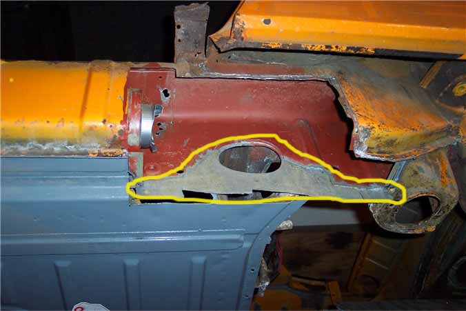

How did you cut out the layer of metal without disturbing the layer behind it? (see below pick).
Are you using 18 gauge metal for this?
Also I'd be interested in knowing what you (or others) are using to cut the sheet metal pieces. I bought some metal snips today, and it seems like it would be very difficult to actually cut any long pieces of metal with them.

rjames   Next set of questions: Do I just cut the jack pla...   Feb 18 2006, 06:05 PM
scotty b   Cut it out, treat inside and replace with a new pi...   Feb 18 2006, 06:11 PM
scotty b   you need to do something with the upper left porti...   Feb 18 2006, 06:16 PM

elocke   Here's that 1st layer installed.   Feb 19 2006, 01:10 PM
elocke   Then the bottom layer with flange to meet the oute...   Feb 19 2006, 01:12 PM
elocke   This piece is the end of the outer rocker, shaped ...   Feb 19 2006, 01:16 PM
elocke   This piece overlaps the outer rocker, as will the ...   Feb 19 2006, 01:22 PM
elocke   Outer layer installation.   Feb 19 2006, 01:23 PM
elocke   I didn't make the parts with the dents for the...   Feb 19 2006, 01:27 PM

elocke   Thanks...this was the pinnacle of the rust repair ...   Feb 20 2006, 09:25 AM
turbo914v8   I have these parts put together as one. I purchase...   Feb 20 2006, 11:50 AM
rjames
  Feb 21 2006, 01:19 AM
elocke   I basically copied the factory layout. When I cut...   Feb 21 2006, 09:04 AM
