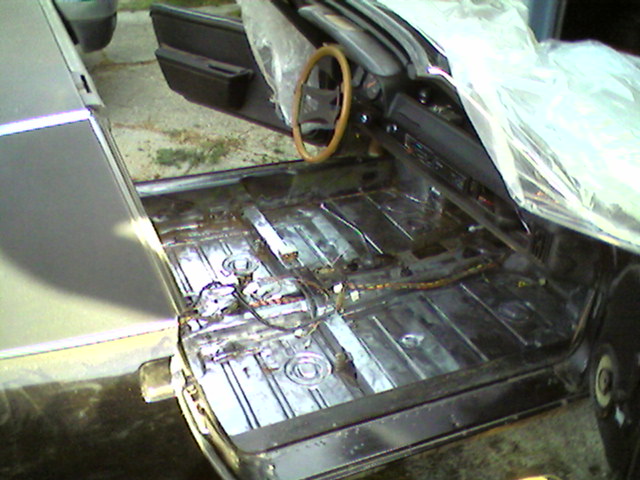

Rust treating, killing, etc, and just want to get some input before I get to crazy with the MIG.
Here are some questions:
I have some floor pan issues. Are the holes too big just to try and fill? The following photo is from the driverside, under the seat after the tar has been removed, and I've grinded down to bare metal. Should I advertise for someone who's cutting up a car to cut this pieces out for me, or should I just go buy some sheet metal and make a patch knowing it won't really match, but can at least be made to 'line up'?

Figured I'd attach a couple of pictures of the shiny parts of the floor pans. I haven't treated them yet, and I got them down to the bare metal just using a 1/4" drill and a lot of different attachments. I was going to use the metal ready, but seeing as the OSPHO is getting rave reviews, I went and picked up some. The stuff was only 13 bucks for a 1/2 gallon. Pretty cheap. I plan to coat it with black cololred POR15 afterwards.

Hammy   You can buy new replacement floor pans. Also any ...   Feb 18 2006, 06:01 PM
scotty b   do yourself a favor and get a new pan section. Tha...   Feb 18 2006, 06:02 PM
rjames   Next set of questions: Do I just cut the jack pla...   Feb 18 2006, 06:05 PM
scotty b   Cut it out, treat inside and replace with a new pi...   Feb 18 2006, 06:11 PM
scotty b   you need to do something with the upper left porti...   Feb 18 2006, 06:16 PM

elocke   I just measured a piece that I trimmed off a Resto...   Feb 18 2006, 06:57 PM
rjames   I was looking at the floor plan that restoration d...   Feb 18 2006, 06:58 PM
Bartlett 914   The seat mounts are extra. They are not on the sit...   Feb 18 2006, 07:03 PM

scotty b   Sorry about the delay, I had a dinner date last ni...   Feb 19 2006, 07:13 AM

vesnyder   I bought my drivers side floor pan from Stoddards...   Feb 19 2006, 10:23 AM

rjames   Ed- Fantastic job you're doing!! Ho...   Feb 20 2006, 12:15 AM
rjames   Figured I'd attach a couple of pictures of the...   Feb 20 2006, 12:37 AM
rjames   'nother. Stupid camera phone isn't the be...   Feb 20 2006, 12:39 AM
elocke   Thanks...this was the pinnacle of the rust repair ...   Feb 20 2006, 09:25 AM

elocke   I basically copied the factory layout. When I cut...   Feb 21 2006, 09:04 AM
lotus_65   assuming the following: repairs have been *reason...   Feb 21 2006, 10:13 AM
rjames   My guesses: If there is rust still present, then t...   Feb 21 2006, 01:00 PM

rjames   I need to cut this piece out due to too many holes...   Feb 26 2006, 03:30 PM
rjames   Also a couple of more questions for anyone and eve...   Feb 26 2006, 03:36 PM
scotty b   drill out the spot welds with a good spot weld cut...   Feb 26 2006, 05:57 PM
