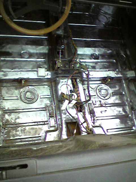

Rust treating, killing, etc, and just want to get some input before I get to crazy with the MIG.
Here are some questions:
I have some floor pan issues. Are the holes too big just to try and fill? The following photo is from the driverside, under the seat after the tar has been removed, and I've grinded down to bare metal. Should I advertise for someone who's cutting up a car to cut this pieces out for me, or should I just go buy some sheet metal and make a patch knowing it won't really match, but can at least be made to 'line up'?

'nother. Stupid camera phone isn't the best for taking pictures...
Really the only issues are with the driver's side, rear area. The rest of the pan is good all around, with hardly any rust pitting if any, at all.

Hammy   You can buy new replacement floor pans. Also any ...   Feb 18 2006, 06:01 PM
scotty b   do yourself a favor and get a new pan section. Tha...   Feb 18 2006, 06:02 PM
