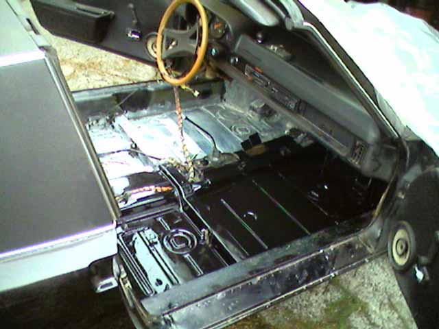

Rust treating, killing, etc, and just want to get some input before I get to crazy with the MIG.
Here are some questions:
I have some floor pan issues. Are the holes too big just to try and fill? The following photo is from the driverside, under the seat after the tar has been removed, and I've grinded down to bare metal. Should I advertise for someone who's cutting up a car to cut this pieces out for me, or should I just go buy some sheet metal and make a patch knowing it won't really match, but can at least be made to 'line up'?
rjames
post Feb 26 2006, 03:27 PM
I'm made of metal
Posts: 4,447
Joined: 24-July 05
From: Shoreline, WA
Member No.: 4,467
I treated the pieces with Metal Ready and primed the weldable edges with weld-thru primer.
Isn't Metal Ready made to be used as 'weld-thru primer'? On the container it says that it provides 'excellent connectivity for welding' or something like that. My thinking was that I didn't need the weld-thru primer if I was using the Metal Ready....
More pictures of the progress: I metal readied the floor pans, and then Applied black POR15 over all but the rear driver's side pan which pretty much needs to be completely cut out:
