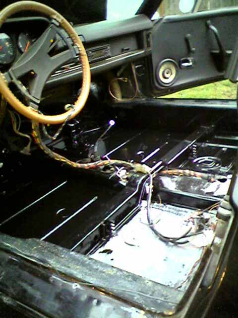

Rust treating, killing, etc, and just want to get some input before I get to crazy with the MIG.
Here are some questions:
I have some floor pan issues. Are the holes too big just to try and fill? The following photo is from the driverside, under the seat after the tar has been removed, and I've grinded down to bare metal. Should I advertise for someone who's cutting up a car to cut this pieces out for me, or should I just go buy some sheet metal and make a patch knowing it won't really match, but can at least be made to 'line up'?

Hammy   You can buy new replacement floor pans. Also any ...   Feb 18 2006, 06:01 PM
scotty b   do yourself a favor and get a new pan section. Tha...   Feb 18 2006, 06:02 PM
rjames   Next set of questions: Do I just cut the jack pla...   Feb 18 2006, 06:05 PM
scotty b   Cut it out, treat inside and replace with a new pi...   Feb 18 2006, 06:11 PM
scotty b   you need to do something with the upper left porti...   Feb 18 2006, 06:16 PM
