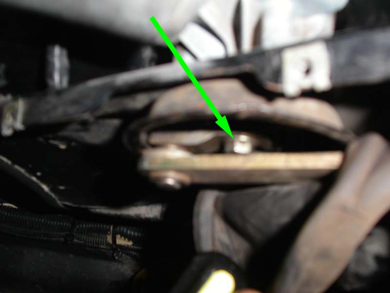

Hi,
Hopefully you guys can help me - my headlamps move but when they "park" in the down position they are not fully down. When you switch them on - they go further down before they raise to the up position. Also they don't move quite together!! (IMG:http://www.914world.com/bbs2/html/emoticons/sad.gif)
Is there any way of adjusting the motor so that they 1. move together 2. stop in the right place.
Thanks for your Help
PJ

this "should" be a 10mm wrench/nut, if i'm not mistaken ...
remove that nut, you might have to pry a bit to get the arm off the shaft.
then refer to the above list as what to do ...
(IMG:http://www.914world.com/bbs2/html/emoticons/cool.gif) Andy
