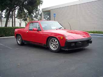

TILL THEN, --this is a photo of the heartlesss REDDdd who should be undergoing surgery next week and back on the road. Again, I'm not a fan of the mullet tail -it came with the ride, but I do like the sunroof targa top -its an intersting touch.
I feel Like I owe you all tuition. After I am finished with the 1.7 I am removing, if you guys have any suggestions for where I should stick it, let me know -otherwise, its going to Valhalla
