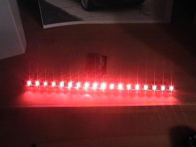

Here's one lit up by a 9 volt battery.

montoya 73 2.0   My mom works for LumiLED. As a matter of fact she ...   Mar 17 2006, 11:33 PM
montoya 73 2.0   Here's a pic of the array.   Mar 17 2006, 11:40 PM
montoya 73 2.0   Here's one lit up by a 9 volt battery.   Mar 17 2006, 11:42 PM
montoya 73 2.0   Here's the last one...   Mar 17 2006, 11:53 PM
