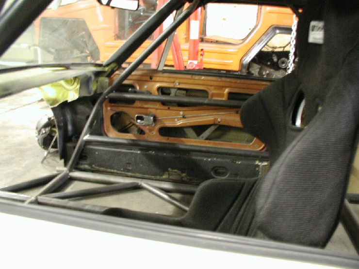

Here is an update shot - not a lot to see at the moment, but the interior cage is basically framed out. The top door bars will be lowered to fit between the window crank and door handle (everything is just tacked right now until I "agree" to weld). The downtubes will go through the stock vents (dash will need a little work to fit). The top hoop fits the targa incredibly well, but I couldn't seem to take a pic that didn't turn out blurry (too much caffiene apparently).
I put the trans and clutch all back together, have the dry sump pan on and so forth, so AJ should be fitting the engine today and said he is going to get cranking this week on finishing out the interior cage and mounting the engine/trans assy.
