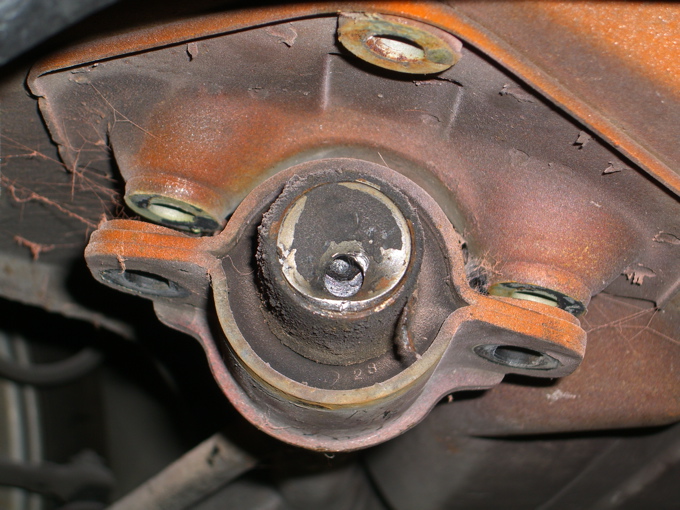

Got my tow bar bracket a couple weeks ago from David Lee.
You can find the thread in the resources section about purchasing one.
They are very sturdy and bolt right into the existing reinforced mounting area for the front of the A arms/torsion bars.
A very nice piece of equipment right from one of our very own. (IMG:http://www.914world.com/bbs2/html/emoticons/biggrin.gif)
Doesn't take very long to install.
The following are a few pics I took during intallation.
The first pic is what you see when you first look under the front of your teener and begin the install. You will see the 2 normal 17mm bolts and inside the protector cup for the front of the torsion bar tube is an 8mm allen. Up inside the little slot on the front of the cup.

Sorry about the delay couldn't get back on the site for a few minutes (IMG:http://www.914world.com/bbs2/html/emoticons/huh.gif)
Anyway, the next shot shows the cup removed and the two 17mm bolts removed. Here is what it looks like before you start the actual install.
remember that there is an 8mm allen inside the protector cup that must be removed to expose all three mounting holes
