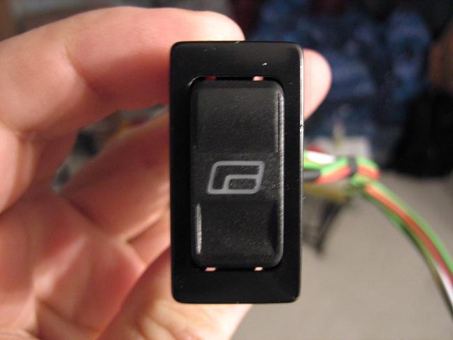

Here is one of the illuminated switches that comes with it:
