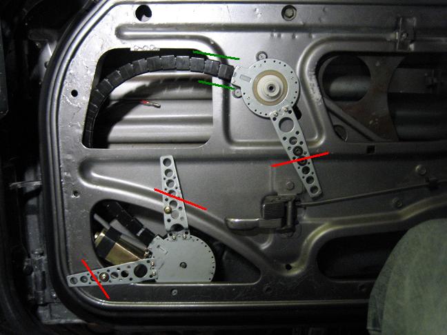

Here is the unit almost all of the way installed. Note- I will be trimming mounting tabs at the red lines and may need to cut the door at the green lines to keep the profile down. I will see about the last part when I trial fit my new door panels.
