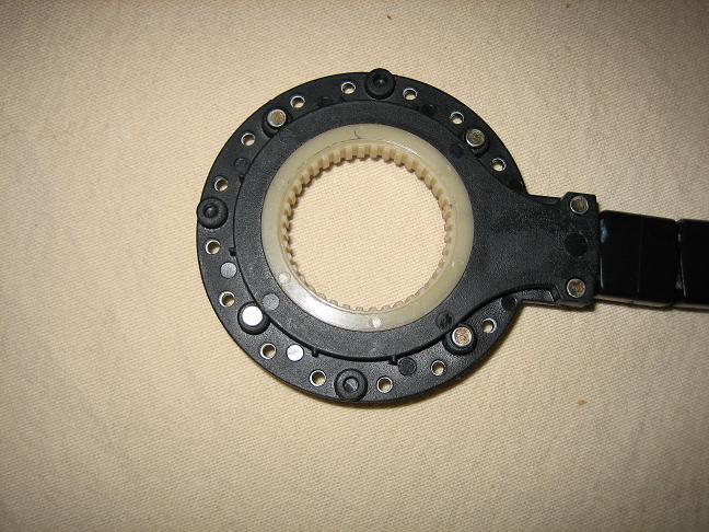

If you look at the above pic you will see how the unit fits onto the crank. For your question I took some pics of the pieces for clarification, though.
This first one is a close up of the end of the drive unit. Notice the toothed inside:

Dr Evil   The toothed interior piece fits over the adaptor p...   Mar 21 2006, 03:46 PM
Dr Evil   The toothed inside of the adaptor fits onto the to...   Mar 21 2006, 03:47 PM
