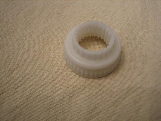

The toothed interior piece fits over the adaptor pictured here:

Dr Evil   The toothed interior piece fits over the adaptor p...   Mar 21 2006, 03:46 PM
Dr Evil   The toothed inside of the adaptor fits onto the to...   Mar 21 2006, 03:47 PM
Dr Evil   This thread may take a while since I am back in sc...   Mar 21 2006, 03:48 PM
bmunday   Mike, I assume that the toothed adapter, mounts t...   Mar 21 2006, 03:56 PM
Dr Evil   All of the kits that I have seen use this very har...   Mar 21 2006, 03:59 PM
Dr Evil   Oh, and there is more than one adaptor that will f...   Mar 21 2006, 04:00 PM
airsix   The good thing about the adaptor being made from p...   Mar 21 2006, 04:20 PM
