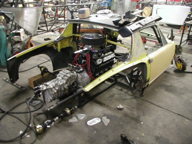

Disassembled the beast over the past couple of weeks in Orange and then AJ (the guy building the tube chassis) did some minor cutting (IMG:http://www.914world.com/bbs2/html/emoticons/blink.gif) I am getting pretty excited about the project though, should be cool if every crazy idea I have works out... never really know until you start piecing the puzzle together.
All things work on paper, only some things work in reality (IMG:http://www.914world.com/bbs2/html/emoticons/laugh.gif)
If anyone really cares I will continue to post pics as the progress moves along... here is some starting pics.
BTW, more pics are on my website in the chassis link I have started.
Here is a shot of week1

and an overall shot from the rear - AJ will start laying out the rear over the next few days and hopes to have that all in place by this Saturday. The rearward main bars will drop a little and the engine will go down a bit too (just sitting on some wood blocks right now that are a bit taller than the final install will be).
So, apparently Andy gets a lot of crap about his pics being blurry - I think I am going to be taking some of that heat for him!

Britain Smith   Why are you running the tranny inverted instead of...   Mar 21 2006, 11:25 AM
Bigbohr   ... maybe to get a lower CG ... Are you using a d...   Mar 21 2006, 04:36 PM
Bigbohr   ok, I see now you're using a dry sump. Never m...   Mar 21 2006, 04:38 PM
byndbad914   Jeroen - bottom "square" outline in the interior i...   Mar 21 2006, 05:03 PM
Bigbohr   ... free to invert ... is what i thought too. Unti...   Mar 21 2006, 07:09 PM
