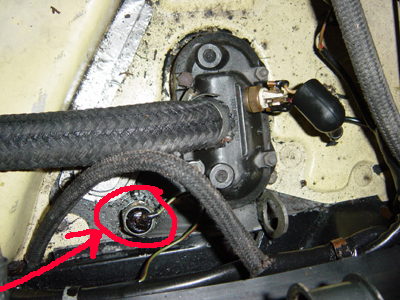

The OEL light flickers where idle should be.
It's .5qt over.
I have to put 80 miles on her this PM, I don't want to roll til I have opinions.
It's setup WAY rich.
M

I had the same problem a week ago! I went out and purchased a mechanical pressure gauge and installed it! There was plenty of pressure so it is the sender that was bad!
Jeff
