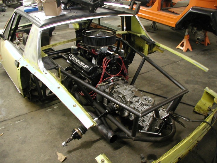

Disassembled the beast over the past couple of weeks in Orange and then AJ (the guy building the tube chassis) did some minor cutting (IMG:http://www.914world.com/bbs2/html/emoticons/blink.gif) I am getting pretty excited about the project though, should be cool if every crazy idea I have works out... never really know until you start piecing the puzzle together.
All things work on paper, only some things work in reality (IMG:http://www.914world.com/bbs2/html/emoticons/laugh.gif)
If anyone really cares I will continue to post pics as the progress moves along... here is some starting pics.
BTW, more pics are on my website in the chassis link I have started.
Here is a shot of week1

and now for the weekend update... overall rear iso shot. AJ lowered the rearward tubes, curved the bottom reinforcement upward to even out the look per my request (you can see a very "squared off" lower last update.

byndbad914   1x2 would be too small... can't find 2x3 so I ...   Feb 21 2006, 05:16 PM
Brett W   Why 2X3 tubing. I build your perimeter out of 2x4...   Feb 21 2006, 06:00 PM
byndbad914   the chassis builder wants to steer completely clea...   Feb 21 2006, 07:01 PM

Jeroen   very cool project... but those tubes look heavy   Mar 21 2006, 10:28 AM
Britain Smith   Why are you running the tranny inverted instead of...   Mar 21 2006, 11:25 AM
Bigbohr   ... maybe to get a lower CG ... Are you using a d...   Mar 21 2006, 04:36 PM
Bigbohr   ok, I see now you're using a dry sump. Never m...   Mar 21 2006, 04:38 PM
byndbad914   Jeroen - bottom "square" outline in the interior i...   Mar 21 2006, 05:03 PM
Bigbohr   ... free to invert ... is what i thought too. Unti...   Mar 21 2006, 07:09 PM
byndbad914   <...   Mar 21 2006, 07:49 PM
byndbad914   here is a shot of the upper hoop - kinda hard to s...   Mar 23 2006, 12:41 PM
byndbad914   better shot with engine and so forth - will be a r...   Mar 23 2006, 12:43 PM
byndbad914   and an overall shot from the rear - AJ will start ...   Mar 23 2006, 12:45 PM

Brett W   The ZR2 Blazer is a 5x5 pattern which will allow y...   Mar 24 2006, 08:03 AM
yarin   Dude, you are building a car around an engine. I l...   Mar 24 2006, 10:13 AM
