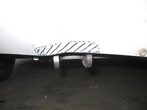

dlee1967   I've had a number of inquiries about how my br...   Mar 28 2006, 03:26 PM
dlee1967   Another variation in angle...   Mar 28 2006, 03:28 PM
dlee1967   Another safety minded 914 owner has asked that I a...   Mar 28 2006, 03:35 PM
dlee1967   another angle   Mar 28 2006, 03:35 PM
dlee1967   last   Mar 28 2006, 03:36 PM
dlee1967   916 cutout ideas   Mar 28 2006, 03:37 PM
dlee1967   straight on.....   Mar 28 2006, 03:37 PM
