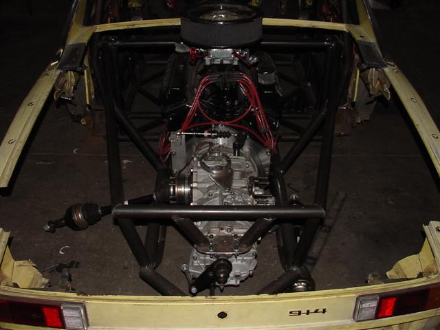

Disassembled the beast over the past couple of weeks in Orange and then AJ (the guy building the tube chassis) did some minor cutting (IMG:http://www.914world.com/bbs2/html/emoticons/blink.gif) I am getting pretty excited about the project though, should be cool if every crazy idea I have works out... never really know until you start piecing the puzzle together.
All things work on paper, only some things work in reality (IMG:http://www.914world.com/bbs2/html/emoticons/laugh.gif)
If anyone really cares I will continue to post pics as the progress moves along... here is some starting pics.
BTW, more pics are on my website in the chassis link I have started.
Here is a shot of week1

byndbad914   1x2 would be too small... can't find 2x3 so I ...   Feb 21 2006, 05:16 PM
Brett W   Why 2X3 tubing. I build your perimeter out of 2x4...   Feb 21 2006, 06:00 PM
byndbad914   the chassis builder wants to steer completely clea...   Feb 21 2006, 07:01 PM

byndbad914   Here is an update shot - not a lot to see at the m...   Mar 20 2006, 05:19 PM
byndbad914   here is an updated shot of engine/trans - exceptio...   Mar 20 2006, 05:23 PM

Britain Smith   Why are you running the tranny inverted instead of...   Mar 21 2006, 11:25 AM
Bigbohr   ... maybe to get a lower CG ... Are you using a d...   Mar 21 2006, 04:36 PM
Bigbohr   ok, I see now you're using a dry sump. Never m...   Mar 21 2006, 04:38 PM
byndbad914   Jeroen - bottom "square" outline in the interior i...   Mar 21 2006, 05:03 PM
Bigbohr   ... free to invert ... is what i thought too. Unti...   Mar 21 2006, 07:09 PM

byndbad914   here is a shot of the upper hoop - kinda hard to s...   Mar 23 2006, 12:41 PM
byndbad914   better shot with engine and so forth - will be a r...   Mar 23 2006, 12:43 PM
byndbad914   and an overall shot from the rear - AJ will start ...   Mar 23 2006, 12:45 PM

Brett W   The ZR2 Blazer is a 5x5 pattern which will allow y...   Mar 24 2006, 08:03 AM
yarin   Dude, you are building a car around an engine. I l...   Mar 24 2006, 10:13 AM

byndbad914   and now for the weekend update... overall rear iso...   Mar 27 2006, 01:52 PM
byndbad914   Jane you ignorant... anyway, here is the sprint c...   Mar 27 2006, 01:56 PM
byndbad914   tailpiece will be flanged to allow removal to get ...   Mar 27 2006, 01:58 PM
