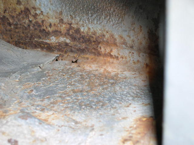

How does one inspect the hell hole looks like you can't see much from up on top.
Geoff looked at mine quickley but I would like to dig a little deeper. Any suggestions

I ventured into the Hell Hole and found it only the purgatory hole the attached photo is the small hole I found, I assume I have to remove the battery tray and patch the hole ?, or are treated little holes ok to live with ?.

SirAndy   take the battery and brain out and get some good l...   Sep 17 2003, 02:15 PM

SirAndy   also, more often than not, it is rusted through th...   Sep 17 2003, 04:41 PM
SirAndy   and the final result, just ingore the sand, this p...   Sep 17 2003, 04:44 PM

Neal   I ventured into the Hell Hole and found it only th...   Sep 17 2003, 06:20 PM
Neal   P.S all the metal except the hole is sound, I poke...   Sep 17 2003, 06:22 PM
SirAndy   patch it. you don't want anymore stuff falling...   Sep 17 2003, 06:36 PM
Hawktel   I think the issue is what does the behind that hol...   Sep 17 2003, 06:44 PM

Neal   Please give me a tutorial on "cut it out" and what...   Sep 17 2003, 09:46 PM

reverie   Neal, it might be cost-effective to ask a local sh...   Sep 17 2003, 10:11 PM
Bleyseng   It would be better to trash the tray and support s...   Sep 18 2003, 07:53 AM
tracks914   Here is a picture of what I had to cut out. With t...   Sep 18 2003, 08:10 AM
tracks914   And after the repair.   Sep 18 2003, 08:12 AM
tracks914   And after that....   Sep 18 2003, 08:12 AM
tracks914   Just wait, I love doing this... and after that... ...   Sep 18 2003, 08:13 AM
914NNP   reverie Please tell me more about the Mercer Islan...   Sep 18 2003, 09:02 AM
mr914   Photo of mine before repair.... Still have much ...   Sep 18 2003, 10:30 AM
Neal   My tray is new, that is what caused this problem B...   Sep 18 2003, 12:37 PM
J P Stein   My battery tray is new, also. It just ain't he...   Sep 18 2003, 12:44 PM
Brad Roberts   Damn how did you get those self tapping screws int...   Sep 18 2003, 12:49 PM
reverie   Neal and 914NNP, You might want to use John Kelly...   Sep 18 2003, 12:55 PM
