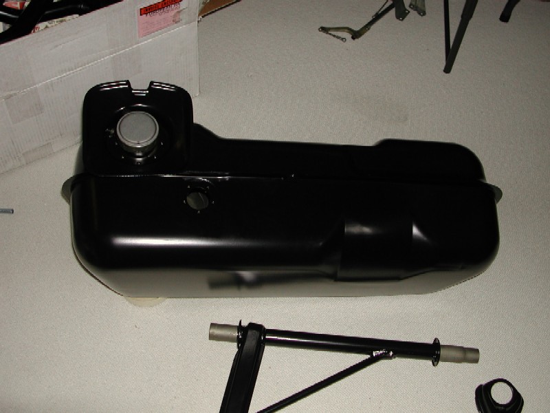

Tank and parts came back from the powder coater today...
A-arm is below the tank in photo. The ends weren't coated to allow for installation of Mueller's needle bearings.
I replated the bearing retainer cover for the trailing arm. I'm waiting for the yellow zinc hardware to arrive to reassemble the rear assemblies. (Maybe this weekend or early next week.
Next to press all the sleeves in the a-arm mounts and the trailing arm for Mueller's bearings
I did everything in a 30% gloss (satin). I'm very happy with the results.
