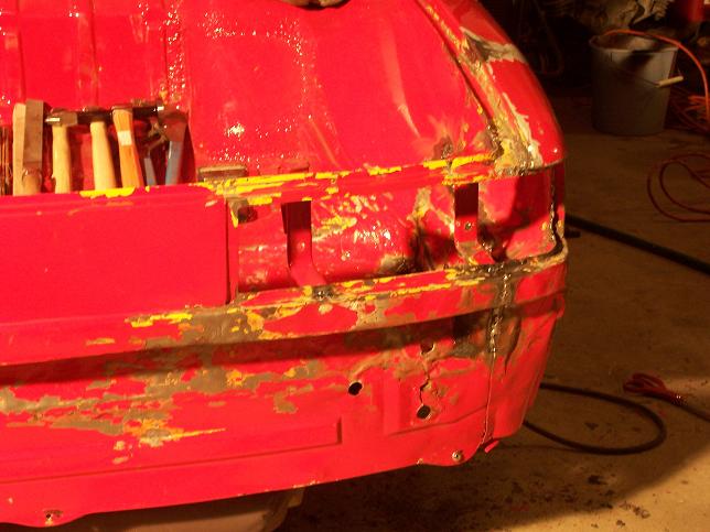

Still working on the damage. Don't make much progress working 1-2 hours every 2-3 days. Here's the latest pics. I'm welding split seams and a couple of cuts and holes that I made.
Just welded the seam between the rear fender and rear panel just below the tail light opening. Also welded the tail light hangers.
