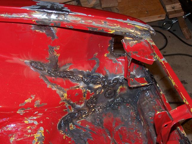

post Apr 4 2006, 09:10 PM
Jerry
Posts: 7,436
Joined: 29-October 04
From: Allentown, PA
Member No.: 3,031
Welded the floor pan to the wheel well. The long weld on the wheel well repaired a cut that I made to make unfolding the wheel well easier.

Spoke   Welded the floor pan to the wheel well. The long w...   Apr 4 2006, 09:10 PM
drewvw   bringing her back slow and steady, I like it.... <...   Apr 4 2006, 09:11 PM
