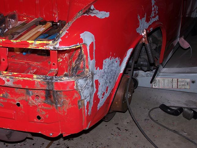

The fender is starting to get back to its original shape. Some of the metal has been stretched by the accident. How do I get it to go back to its original shape?

Dave_Darling   Heat will shrink the metal. Ask JP about how his ...   Apr 4 2006, 09:51 PM
