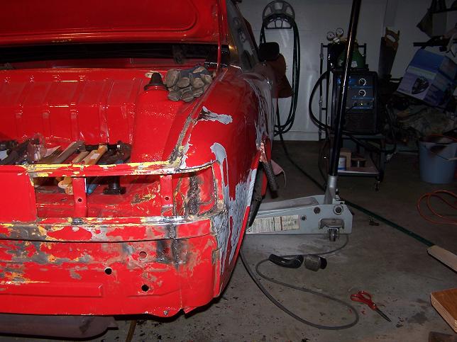

I've decided to keep my wrecked red car until my new 74 2L 914 from Part Pricer is road ready.
I just needed to pound out a few dents to get Big Red back on the road.
Here's a couple of before pics.

Nother side view.

Spoke   Still working on the damage. Don't make much p...   Apr 4 2006, 09:05 PM
Spoke   Welded the floor pan to the wheel well. The long w...   Apr 4 2006, 09:10 PM
drewvw   bringing her back slow and steady, I like it.... <...   Apr 4 2006, 09:11 PM
Spoke   The fender is starting to get back to its original...   Apr 4 2006, 09:12 PM
Spoke   Nother side view.   Apr 4 2006, 09:13 PM
Spoke   Tail light fits pretty well. I've used cardsto...   Apr 4 2006, 09:15 PM
Spoke   The trunk is the next project. The hinge on this s...   Apr 4 2006, 09:20 PM
Spoke   I noticed this little crack by the passenger door ...   Apr 4 2006, 09:36 PM
Spoke   Picked up a chrome bumper in Jersey. $10 from...   Apr 4 2006, 09:39 PM
JOHNMAN   You have done an amazing job getting the car back ...   Apr 4 2006, 09:50 PM
Dave_Darling   Heat will shrink the metal. Ask JP about how his ...   Apr 4 2006, 09:51 PM
