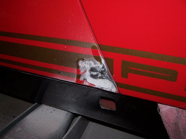

I noticed this little crack by the passenger door before the wreck. It got bigger after the wreck so I decided to grind it down to find about 1/4 inch of bondo.

Spoke   I noticed this little crack by the passenger door ...   Apr 4 2006, 09:36 PM
